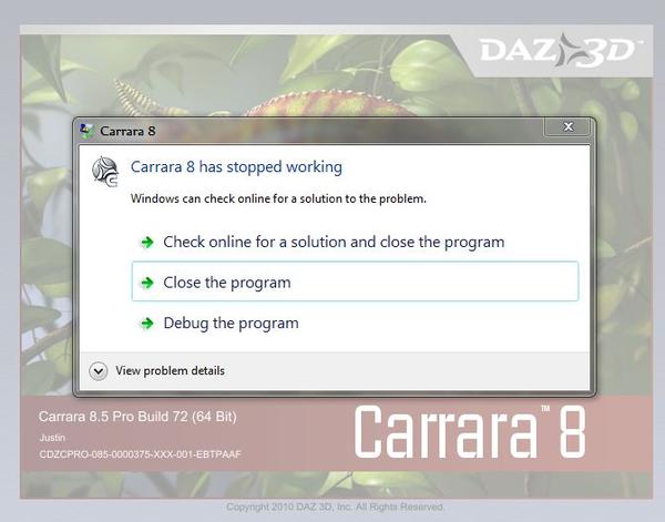

MalusMalus Posts: 239
This is a carrara bug so I don't really know where to put it. I saw daz bugs, but no carrara so I probably got it in the wrong place. Anyways to the bug. This bug occurs quiet frankly every time I open carrara now. I thought it was just idiotic crash that happened once, but nope every time I open carrara. it was working just fine then my computer pulled it's stupid black screen thing when I close the laptop and crashed. Now carrara does this, it has done this three times in a row. Here is the pic.
672 x 528 - 53K

    Next time it happens, click the section at the bottom of that window "view problem details"
    click and drag inside the area which opens up, and select all the text,. then Hit CTRL+C (Copy)
    then "close the program",.
    make a new text document, and hit CTRL+V (paste) and save the file as "crash.txt" (or something like that)
    that info will give some idea of what's actually happening.
    For reporting bugs, you need to go to Mantis and set up a new user name / password (if you haven't done that already)

  • MalusMalus Posts: 239
    I didn't reinstall 8.1 (lol) I had the same amount trouble out of 8.5 so I said screw it and I installed 8.5. Nope haven't uninstall or removed plugins? No other issues with my computer beside the usual, but carrara is the only thing acting up.
    What is Mantis?
    Also here what the thing said (If you wondering I can't open carrara at all with out this happening so I can always bring the error back up)
    Here is the copied info.

    If you're not using C8 right now,.. Uninstall it,. then delete any files and folders remaining in Daz3D \ Carrara8.
    All your own saved stuff, like shaders or models will be in your "My Documents\Daz3D\Carrara8\Presets....
    If you're using the beta.,..
    Q: Is this a fresh install into a new folder, or is it a re-install,.. into the same folder where the previous beta version was (which gave you problems with C8)
    It's sometimes best to do a "clean install" .. by removing the program completely,.. re-booting,.. then installing the program again, making sure that there are no files left from the old installation, before you install the program.
    My advice still stands that you should uninstall Both C8 and the Beta,.
    make sure there's no files or folders left after un-installing.
    Reboot the system.
    then install the version you want,. (although,.. there should be no problems with having both C8 and the 8.5 beta installed,.. as long as they're installed into completely different folders)

    I couldn't help but notice that you're trying to use an old beta build (version 72).
    I recommend downloading a newer version before spending too much time troubleshooting the old one.
    There were four more released since 8.5.0.72:
    Carrara_8.5.0.107 beta
    Carrara_8.5.0.132 beta
    Carrara_8.5.0.149 beta
    Carrara_8.5.0.172 beta
    Also, installing the actual non-beta 8.1.1.12 for comparison might be a good idea.

  • GarstorGarstor Posts: 1,411
    Problem Event Name: APPCRASH
    Application Name: Carrara.exe

    Yep. This is a bug alright - but there is not enough information here to say more.
    "Fault Module Name: NetworkRendering.mcx"
    OK, did you ever setup network rendering? If it is enabled now can you disable it? Does that help?
    "Exception Code: c0000005"
    This code is an "Access Violation." Hence my saying "it's a bug." Without getting too techie on you, basically the program code got an invalid memory address (probably all zeros, aka a "null pointer") and tried to use it. Windows protects certain areas of virtual address space and you get an Access Violation if you try to use these areas.
    This should generate a memory dump of the Carrara process. DAZ programmers can use that dump to figure out exactly what caused the AV. If they will do this for you is another question...but I used to look at memory dumps of SQL Server all the time at Microsoft. Fun times... :)

    Good eyes! I missed that bit. Access Violations often go away with newer code.
  • FenricFenric Posts: 347
    If you aren't using network rendering (rendernodes), you can remove the three files "NetworkRendering.dat", "NetworkRendering.mcx", and "NetworkRendering.txt" from your Carrara\Extensions folder.
    I agree that is the fastest test for a solution. Followed by upgrading to the latest bits.
    But my first reply was a bit hasty ... it is possible that there is a bug that is not Daz's fault at all. It is called a "scribbler" because it is a bug in a device driver that is writing on memory that it doesn't own.
    Normally if you try to write to a memory address you don't own, you get that Access Violation that is the source of your Carrara crash. Note that I said "device driver" though. Those reside in a special area (along with Windows itself) and have the "power" to write anywhere...fun little buggers to chase down...
    It sounds like a network stack problem, and that is perhaps the worst of the lot to hunt down. The network render module is fairly trivial: opening a multicast, promiscuous mode (sorry, that's what it's called) UDP port and then listening to it.
    It shouldn't crash like that. It shouldn't be ABLE to crash like that. It's a driver level error, but why?
    So... driver corruption tends to make things in the network stack just plain not work at all. I'm inclined to think hardware - a surge over the network cable, or a capacitor going out.
