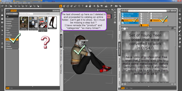

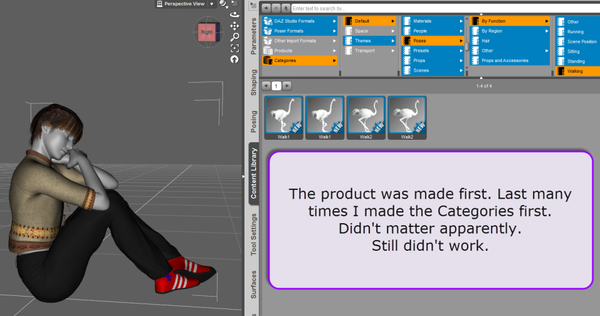

‘K, the antibiotics are helping, had my chocolate bar ... tried metadata again.
Maybe I’m missing the point of metadata ... or what to expect from it ... or a vital step ... or gee, does this work 100% of the time even?
D/S4.0
W7Pro64bit
turned av off
closed/open D/S many times
saved out the new metadata after changes ...
nothing is working to get the “product” to show in Smart Content whether Genesis is selected or not.
I can get it to show via a direct request through the Content Library.
Have reset the database and re-imported in “all” the metadata ... many times. [by the way, one cannot touch D/S when doing that or it has seizures] ... too much stuff to ask the program to comb through all the files looking for everything [in case it was just a miss] ... more seizures.
This isn’t a “new” unassigned product, but a set of poses. One of several I was hoping to get into the Smart Content panel.

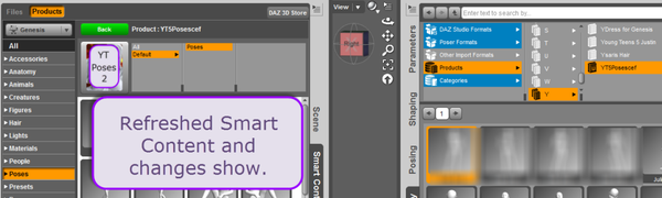

I checked through the files and you know, I thought I had added compatibility because when selected the information showed on the space underneath saying so. But it certainly didn’t say so up where the “X” marks are and so yes that was a definite miss.
“Right-clicking” and adding the info ... made a world of difference grin
Thank you so much.
