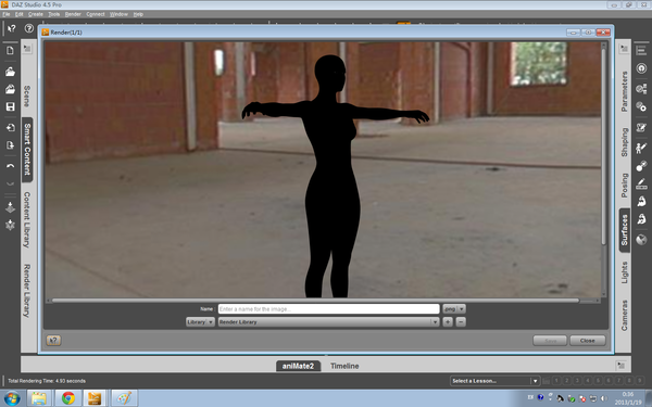

well...based on the tutorial video
i tried to set the uber area lighting
but some problem just appear
my people just be black!
what is the problem
can just anyone help me plz!
1440 x 900 - 666K
Post edited by b9502032 on

  • edited December 1969
    Are you using occulsion with soft shadows option in uber?
    Go to sceen and select uber. Then go to parameters. Go to light and check the environement option there

  • b9502032b9502032 Posts: 0
    it meaning the inside of this sphere is not lighting
    but i exactly set the scale -100
    did you set z rotate to 180
  • SzarkSzark Posts: 10,085
    Can you show the Scaling Parameters of the sphere which is in the Parameters Pane when the Sphere is selected.
    If you set the Scale slider to -100 then it should be inside out. If it is scaled to -100 then make it a positive value and test that.
    DONT USE PRGRESSIVE RENDING as there are still bugs with using that feature.
    this is my parameter of sphere
    i already set the scale and z rotare
    but its still not inside out
    1440 x 900 - 551K
    edited January 2013
    whatever i set the scale postive hundred or negetive hundred
    the lighting always outside not inside
    and what is prograssive render
    i click the camera pic in the top right coner to render
    is does matter?
    so how can i render that?
    I know for sure that is the problem about inside out
    beacuse i craet a defult uber area light sphere
    and i set the sphere's scale -100 but its still lighting
    so how can i do then i can revers the surface
    see the picture
    1440 x 900 - 346K

  • wancowwancow Posts: 2,708
    Yes, basically the problem seems to be this: setting a scale of -100 is simply not turning the sphere inside out. I tried it twice and it's just not working.
    There is a solution, reverse normals on the sphere in Hexagon or another modeller.
    http://www.youtube.com/watch?v=9F1_1rWDUDU
    Okay, this is VERY interesting... it's not working after I flipped the normals either...
    hmmmm... what be wrong with this picture?
  • KhoryKhory Posts: 3,842
    It is working correctly for me. Be sure that you have ambient checked ON in the surface tab by the way or the inside of the sphere will remain black even though the figure is lighted. Also be sure to adjust the intensity or you will get little or no lighting on the figure. I'll post a render shortly.
    yeah i already checked ON the ambient
    if you didt check on then the whole image you render will drak
    if you checked ON then you can see the background
    but the figure still dark if u put the figure inside the sphere
    because the normal of lighting is outside whatever u set the scale -100 or +100
    I'm using 4.5. Are you raising the intensity on the surface tab high enough? For the render I have going I raised it to 700 because it is a pretty dark image and suspect I could have gone higher. It would depend on what additional light I planned for the scene.
    i use 4.5.1.56
    I set the intensity at 600, set the scale at -10 and lowered it so that I could see the outside... it's emitting light on the outside, not the inside...
    I'm using DS 4.5.1.56
    Trying to get this silly image to go up properly.
    Let me check on my other computer. I has that version.
    500 x 500 - 153K
    I think there is something wrong in this version. But.. I don't think it is the uber surface light that is the issue since I could get it to work on a different primitive. I have no clue in the world what is going strange with the sphere though.
