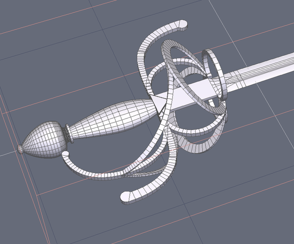

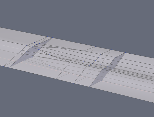

Hello!
These are a couple of screenshots of my first Hex 2.5 model, and I know I made some rookie errors. How do I get rid of some of the interior "leftovers" from where I welded two constructs together? For example, there is a cross section surface inside the blade, as shown in the screenshot.
Thanks!

  • lexbairdlexbaird Posts: 144
    Follow up question: Apparently "n-gons" (shapes with more than 4 points) are problems? At the tips of the knucklebow and quillons, there are partial cylinders, which means the flat round parts have more than 4 points around the perimeter. Should I try to fix that?
    380 x 360 - 18K
    Short answer...YES!
    Somewhat longer answer...any smoothing or subdivision applied to the surface will turn it very ugly, at the least, if it just doesn't break the mesh.
  • Wee Dangerous JohnWee Dangerous John Posts: 1,020
    Nice sword lexbaird. I see what has gone wrong, when you bridged the two sections together you did it by bridging the faces rather than the lines, this left the original face behind. To fix the problem select a face above the unwanted face and use the hide faces option (bottom right of Hex you have 2 spheres, one has been cut in half - 3rd box from the right), simply hide the face and delete the unwanted one.
    As for your second problem, delete the top face, then bridge the lines which are opposite each other, going by your picture above start at the widest part and work your way up bridging each set of edges one at a time (you could do more than one, but best to be on the safe side).
    Oh, the part known as the blood groove needs a couple more tesselations, one on each side of the shaped bit, so it will keep it shape (the same goes for the cutting edge).
    I like the look of your sword, please post some images when you have finished it :)

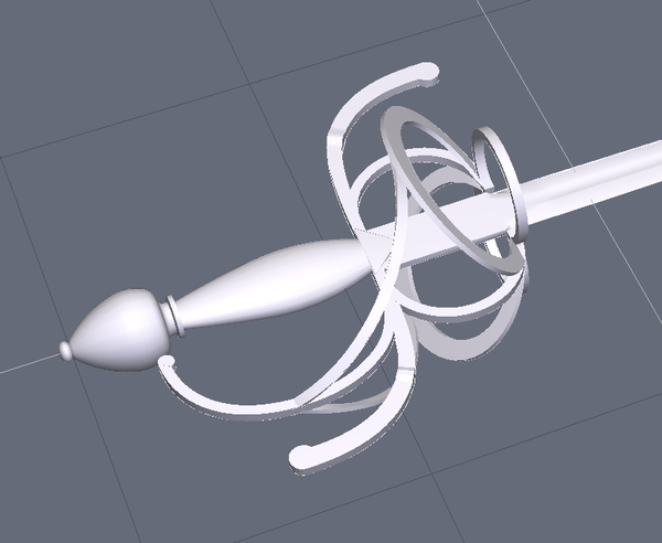

    Thanks! Sounds like I am on the right track. Due to the weird intersecting tri-ring area, I ended up with vertices not quite totalling up evenly, and thus two small triangular holes hidden under the rings. I'll just fill them.
    Good ideal with the morph target for a bend! Now, I have to figure out how....
    Also, I only have the vaguest idea what "sub-D", pre-smoothing, and mechanical beveling mean yet. This model has some rounded edges done as actual vertices, and everything looks pretty good without any smoothing (smoothing level 0). I'm thinking I'll leave it there. Is there a way to use smoothing on only part of a model, like the hilt, but not the blade?
    Currently, I'm messing with UVs.
    I'm attaching progress pics, including the complex intersection under the rings, and where the blade section just dives into the triangular hilt buffer.
