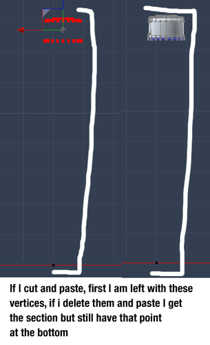

Greetings all, I hope someone can help me with this.
I modeled this in hexagon and brought it in to carrara to texture and while making shading domains and hiding selections I get this curious edge and vertex when I click in the window. The vertex at the bottom of the edge is below the bottom of the bottle and is not connected to anything. I cant select it. If I select all by keyboard command the edge and vertex are not selected and it appears clean. Granted I am not very good at modeling but plod along until something like this comes along. Sorry for the long winded question. Oh and one other thing, why am i left with those vertices in image 2 when I cut and paste? Thanx very much. And if anyone is suspicious that this post is a joke, rest assured it is not. Thanx again

I too use HEX as my number one modeler then export import into Carrara but have never run across this!
Try this in Carrara .. select the ERRANT POINT then select dissolve, I think is what it is. OR find out what PLOY it belongs to and simple DRAG it up to your liking.

Are you in the vertex modeler when you are trying to delete the stray vertex ?
I have found that if you are doing ruled surfaces,double sweeps, Gordons, or coons in the vertex modeler you will get strays such as you are showing, but to delete them you must be in the modeling room….use the sissors to cut em out.

Without looking at the actual file, I’d say part of the problem is duplicated vertices…try ‘welding’ or removing doubles or what ever Hex or Carrara offer.  The rest may be from subdivision/smoothing…especially with ‘extra’ verts.
But often, when an errant vert pops up like that, you need to scrap it and start over.  In this case, probably just redo the cap…

My initial thought, and this could be way off, was that it might be a visibility issue. You said you were hiding vertices, and sometimes, when you’re not seeing the whole thing, selections might not work as you thought they would.
It’s hard to explain, but if, for example, an entire polygon is not visible, just one edge of it, and you’re in polygon selection mode, you’ll click on the edge and nothing will happen. Bad example, but maybe if you try unhiding everything you’ll be able to select it. Or maybe you think you’ve un-hid everything, but not really, and some parts are unselectable.
And if you’re doing it in the Carrara modeller, that’s even tougher, since it has very few of the basic tools required for detecting and fixing bad meshes.
Then again, it could just be some random wackiness like others have suggested, and your best bet might be to start from scratch.

Can you show any examples of a “Single point polygon”, .or a “two point” polygon ?
A “Vertex” is a single point.
Two vertices can be connected with an “edge”.
Three or more vertices connected by edges, can be filled to form a Triangle, Quad, or Polygon.
Since the user modelled in Hexagon,. then that would be the best place to check it for errors,... Ideally before exporting.
In Carrara, you can select the vertex or edge and easily delete or dissolve them, but it doesn’t solve the real question of “What process created the problem in the first place”.
I personally find it really annoying to see simple models like this being built in hexagon, and imported into carrara, because it’s just so simple to build models like this in carrara,.
It would probably take less time to model this in Carrara than it would to jump out of carrara, and open up Hexagon.

1 Yes Im in the vertex mod room
2 Scissors has no effect
3 welded in hex before saving as carrara file in Hex and exporting as object from Hex
4 3dage may be on to something. if i bring the cursor close to that point it changes to the cursor that will select polygons but will not select. I’ll try building it in Carrara, but for some reason I just like hexagon.
That stray point doesn’t seem to effect the model that i can see, its just there
I would like to take this opportunity to thank everyone for there help, on this and in the past. Without this forum and everybody in it I would be lost. Thanx again and a healthy and prosperous new year to all

One way to fix in Carrara;
Set the selection tool to Polys only,
Select everything,
Copy
Paste into a new vertex object.
That should eliminate any stray points or edges and may reveal any other issues.
If you go back to the original model and delete the selection you can see what was left over.

did what you suggested but that point or face persists. it is only there when i hide selections. the cursor does change to select face even if i have it set to select points only. when i go to uv it this is what happens. see image. Im going to chalk it up to poor modeling and just redo it. the model looks fine to me in hex. what thjat is in the uv room is way beyond me. multiple vertices occupying the same space. i selected the vertex and it selects the whole model as though the whole model inhabits the same vertex space.
