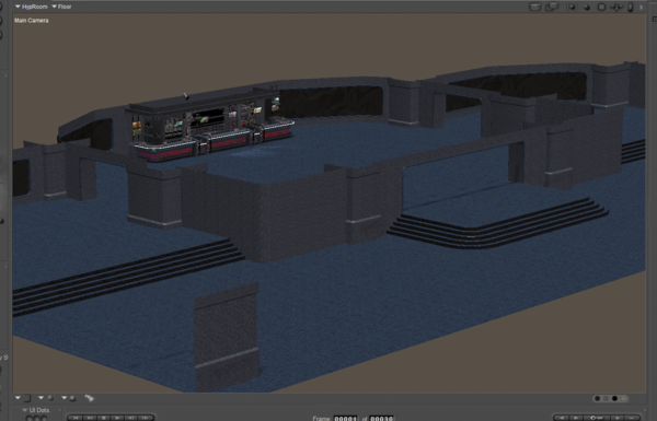

I have returned to using Poser as I recently got the Octane Render plugin for poser pro 2012. I have noticed, and I also see this in Poser Pro [7], that sets that have walls -- Hyperion Bar and A-Deck, so far -- those walls are invisible in the camera preview. The walls will render fine, but when placing the camera, I can't tell if it's inside the wall or inside the room. Is there an option somewhere to disable this feature?

    I don't know what "single sided objects" are, but this problem hasn't existed in any version of DAZ Studio I've used (2.x - 4.5) and I don't recall it in earlier versions of Poser that I used (versions 6 and 7). Is there no way to correctly display these models without going through the extra steps you outlined?
    Attached are screenshots of the two models in DS 4.5 (Hyperion only comes with Poser shaders)

    The polygons that make up the mesh of the figures have a "front" & a "back" face. Poser's preview only sees the "front" of the face whereas DS can see either side. So if the polygons are facing the interior of the figure; Poser won't show them in the preview screen unless the 'front' is pointing toward the camera (as can be seen in your first post). You might try switching to wireframe to set up your scene.
