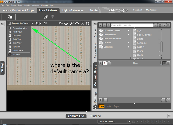

Normally when i start a new scene in Studio, the default camera appears in the drop down list...the strange thing is...that sometimes its there...and other times its not...why is this?...how can i add it if its not in the list?...
1024 x 740 - 305K
    You can add a camera from the Create menu, and call it whatever you like, icluding 'Default Camera'
    If you want one to always appear, go to Edit > Preferences > Scene, and tick on 'Create a Default camera'. Every time you create a new Scene from the File menu, a default camera will be created as well.
