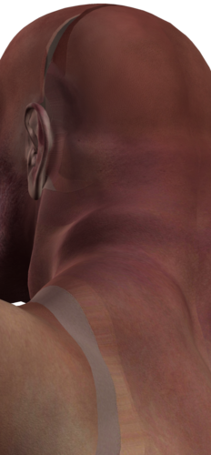

I thought skin textures made for M4 would fit figures created with Genesis.  I imported Genesis into Poser 9.  In Poser I try to apply M4 skin textures, and none of them fit.  All of them are distored (like the black of the nostrils appears on the side of the nose of the figure), or the texture splits appart at the seams and there are big gaps of non-texture visible.  These M4 textures I have are the Poser versions of the textures.  The figure is Genesis.  Does anyone know what I’m doing wrong?

Are you using the right UV mapping mode for genesis ? I gather you can change the way it is uv mapped, to equate with the skin that your are using, so M4 skin would need Genesis to be in M4 UV mapping mode.

Mec4d.com has a free set of UV switching presets for use on Genesis in Poser.  Apply the M4 UV switching preset before applying your M4 texture.

Go to the following link
http://www.mec4d.com/store/index.php?_a=viewProd&productId=86
Mec4D had produced a very handy set of material setting for Poser that chance the UV layout prior to applying a texture to Genesis.
It should sort out the above issue.

Go to Daz Genesis in your Materials folder, there you will find Sample Jeremy, Sample Lana and Sample Child. Apply Sample Jeremy and it will switch Genesis to M4 UVs, then you can apply any M4 MAT pose and it will work properly, Sample Lana = V4, Sample Child = K4

The Mec4D scripts have the advantage of not loading more textures you won’t use, so they would be preferable. Note that you need to manually set the UVs only if you are using Poser materials - if the item has .duf presets with companion files then those should set the UV set before applying the (hopefully Poser-optimised) materials.
