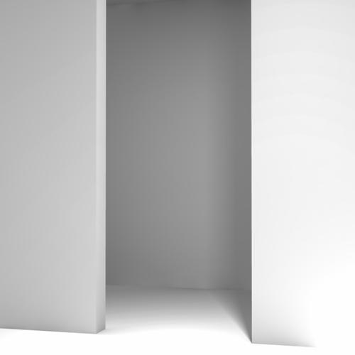

Here is an example of why I don’t use GI much….
The top image uses GI to “fill in” the lighting. This is pretty much the default setting (100% Indirect Lighting, Interpolation = 20%, 5000 photon count…) If you click the image you can see “ashiness” in the lighting so this initially has a *wow* look of GI, but on closer inspection this is not acceptable…. I could turn off Interpolation and step up the photon count, but this image already took almost 2 hours to render….
Now look at the bottom image. This is where I “faked” GI. The scene uses 6 Ring Lights at the top of the columns. All I did for the “fake” GI is duplicate the lights in the scene, cut their brightness in half, and drop them down to the floor at the base of the columns…. Now there are twice as many lights in the scene, but it renders in 2min 45sec. Go ahead and look at the image large. It has no ashiness, but the lighting is very close… nearly identical… But with a few minutes extra work with the lighting in my scene, I have saved 1hr 57min of rendertime….
GI is actually the “fake” method to get good lighting. As you can see it comes at a ridiculous cost in rendertime.

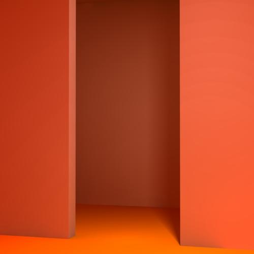

A little more refining: For my “bounce” lights I have reduced their saturation to about half, and I’ve changed the Shadow Intensity to 60%. I’m pretty happy with this lighting. It’s not *exactly* like the GI, but now my scene is rendering so fast that I have the luxury of tweaking the settings and re-rendering until I get it right…. If I wanted, I could keep adding more very low brightness fill lights, but I don’t think it’s necessary to get a convincing image. I also have the advantage that I can change the saturation of the “bounce” lights which helps to bring out the architecture a little more.
