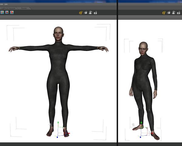

Hi,
Today have bought Shimuzu’s Stephanie 5 Poses and i’m really disappointed of it since it’s changing not only the pose as it just should, but the morphology and size of the character, despite the description said
“This collection contains twenty-five poses for Stephanie 5 based on model pose techniques on how to create the best angles through form. They are ideal for portrait and artistic renders, or showcasing Stephanie 5 clothing creations. Each pose has been carefully crafted to look its best from multiple angles, including close ups. They can be tweaked to be used with any genesis figure or body shape. There are alternate variations for some of the poses. These poses work best with the Rotation Limits turned off.”
http://www.daz3d.com/shop/shimuzu-stephanie-5-poses
Anybody else encountered this problem ? I own other “S5 poses” wich work perfectly with any Genesis-based characters.
Is a fixing patch scheduled for correcting this bug ?
Thanks in advance

Yes I have trouble with that too, with this pose set and with the Gorilla poses.  They both change the morphs / size of the figure.

There are a few pose sets like this - while you put in the support ticket, in the mean time you can apply the pose, then go to the tiny menu on the parameters tab and “zero figure shape” to get back to defaul genesis shape while keeping the pose in place.

thanks for the info Canary3d, i didn’t knew about it… sadly, when using it, i lose all the tweaks i made on my character
i found an alternate way to handle this problem, in the shaping editor, i send S5 back to 0% since it keeps my other tweaks on but i guess i’ll save each pose in spare files and use these ones before they fix it, if they do it

If you ctrl+dubble click the pose, you should get a popup.
There you can untick the Morphs, and it should only aply the pose.
Offcourse not going true these things would be better smile, but it’s a sollution.
Hope this helps somewhat.

That might work with the S5, but dialing out the Gorilla also cleared part of my figure morphs because the Gorilla has other morphs linked to it.
