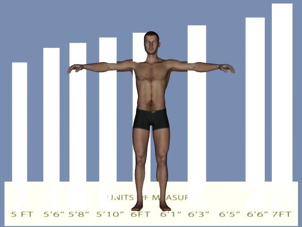

I want to ask a bit of technical question. I think I've already answered it. When bringing a primitive plane into the scene, are they in proper scale? I guess they would be. Using the primitives-measured in inches-I've determined the basic default M4 character is at 6 feet, Brock and F4 are 6'1". Is this correct? And using the scale I've created I've been able to set the M4 at 5'8" up to 7 ft. The reason I ask is for the sake of variety and setting up scenes in proper scale and balance. and when I create stuff to measure it out in relation to the scene. By default when bringing in the primitive plane at say 6ft, that's 6ft for each side-X and Y, I scaled the x down to 10% and compared the M4 character to it. And he's right at the 6ft mark (72 inch). And the primitive at 73 inch, Brock is 6'1". And the main reason I ask again is for setting up a scene. I had created a parking lot, and using McLean Streets for measuring the spaces for the cars but something still doesn't look right. Oddly enough, I've been looking and studying some parking lots to compare if I have it close enough. Otherwise, is the primitive plane the best to use for measuring with accuracy? I think I answered my own question...
Just to show you what I mean...

    When bringing in a primitive, the unit of measure it gives a choice from meters to miles, so for the human figure I did it in inches. So M4, when brought into the scene measures 72 inch=6 ft. I was going to try metric, but I'm just too usd to inches,feet, yard,etc.
    I'm sure the measurements on the streets is accuracte, I guess I've never really noticed the size of a parking lot until recently when I started looking around town for modeling ideas. And creating the village and buildings I noticed I needed parking lots to go with the building(s), and using the Streets was the best source to measure the spaces. I didn't think to look it up until you mentioned it. Now I have a guide. And using the Street I got it right. I had figured enough space for the individual parking spaces, and then enough room for two cars to pass through the drive between the perpendicular spaces, using the streets as my guide and then brought in a primitive at 7 ft, it measures almost four squares end to end for the perdendicular spacing, and two of those enough for two cars to pass through. I counted the typical (group) lot has enough space for 10 to 11 cars to park side by side, 22 in the whole square.
