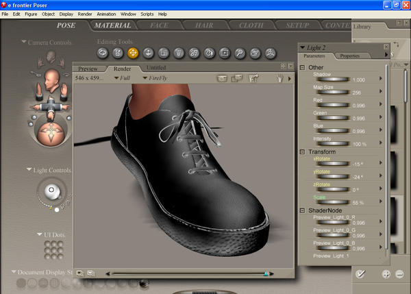

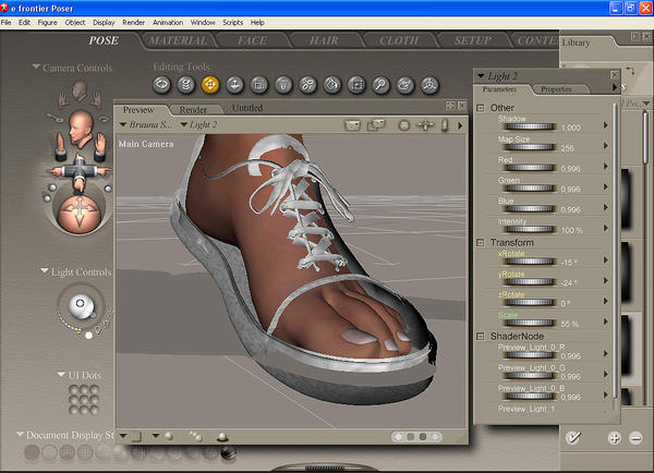

I’m no master at clothes. I’m learning.
I honestly do not know what happens to my clothes.
Nothing was done in DazStudio. I model the clothes in Hexagon. I do UV in UVMapper Free, Groups in AutoGroup Editor and Conform clothes in QuickConform.
I apply the textures in Poser, save materials, and apply in Cr2 with NotePad + +.
The Morphs using the bridge DazStudio for Hexagon. Save in CR2 in plugin DeltaX - Morph to Cr2.
It’s simple. But some things do not work in Poser, but everything works DazStudio.
Shoes show themselves invisible in Poser and make Render, are dark.
In Daz Studio are perfect.

In the case of the shoes…it looks like flipped normals.
They’d probably look the same in DS4.5 as they do in Poser…but in 3.1 DS pretty much ignores normals (not really, but that’s the net effect).  Try flipping the normals in Hex.  If you are using external geometry (not contained within the CR2) all you should need to do is open the obj (the one that’s referenced in the final cr2), flip the normals of the affected parts (if you flip all of them, you could end up making the now visible parts ‘disappear’ ) and resave.  There are settings in Poser that can be used to get it to display correctly, but fixing it at the geometry level is better…

Thank you my friend. I know the problem of the shoes now. I do not know is how to fix this, but I’ll try.

Dear Friend @ mjc1016.
Early in his explanations, I got confused.
Reverting to normal OBJ, it only has numbers.
The solution came with simplicity, and use UVMapper,
Problem solved very easily.
