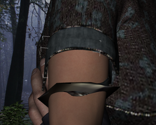

Hello!
When I pose a genesis figure (V5 supermodel) the Katumi dress http://docs.daz3d.com/doku.php/public/read_me/index/14304/start  adds strange ‘armbands’ to the lady, see pic below. Have anyone seen this and know what there is to be done?
The Katumi dress used to be sold by Bobbie25 but is apparently not for sale anymore.
I’m running 4.5.0.90

That’s the drawback of collision detection - if the figure cuts through itself, or the clothing, the algorithm will push the clothing out. Arms down poses can be a real problem as there’s very little clearance. You could try turning smoothing off, or lowering the number of collision iterations, which may or may not look O; if not, you could try using a DForm to pull the fabric between the arm and the upper body towards the body more, or you could adjust the pose to leave more space.
