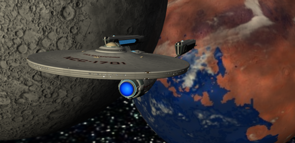

There used to be a freeware space scene creator out there… maybe eight or ten years ago?  Was it Universe?  I can’t remember.
When doing this scene:
http://www.renderosity.com/mod/gallery/index.php?image_id=2332697&user_id=647585&np;&np;
I used three spheres.  One for the earth surface.  One for the clouds, and one for the atmosphere tinted blue.  I had to make my own transparency map for the clouds, but I found them on the web ready to wrap around a sphere.
