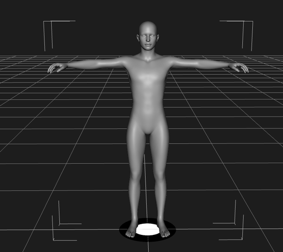

Somehow, I have turned on something that I can’t seem to turn off. This disc appears in every scene, whether I load a saved scene or create a new one. With it active, I can’t select anything in my scene; the disc doesn’t appear in the Scene list (at least, not that I can find); and I can’t seem to find anything in the Menu that affects it. I honestly don’t know what I did to activate it, and I wasn’t doing anything I don’t normally do—and yet, it suddenly appeared. It almost looks like a D-Former base without the manipulator. Can someone please tell me what the hell it is, and how do I turn it off? Even restoring factory defaults doesn’t get rid of it, and as it is, I can’t do a damn thing. Thanks…

Easy fixed don’t panic. It is just the aniMate2 tool. Choose another selection Tool from the Tool menu.
Oh, jeez. I’ve never used DAZ’s animation tools, so it’s no wonder I didn’t know what it was. Thank you very much.

No I don’t do animations I had to go looking for what it could be.  smile Never seen that before either.
