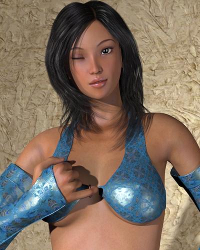

I do not know why it happend,, but I set some shader preset,, (thanks much,, silkessence and fabricator,,
I really love these shader,, it is simple and easy for me @@; though I can not yet use well them,,)
these line shown up, after render simple pic.
I change setting opacity first, but it seems no reference with the problem,,
this is my hand made tops,, so I want to use if with a many sets of fabricator,,,
so is there way to avoid this line when render and spot render,,?
I checked with different preset, and render again,, it seems not happen,,
(I am now studying to adjust,, humansurface setting,,
so not mention please,, her eye point at strange direction, or setting light is wrong, or part of sikin coloer
seems strange,,etc ><; I changed light setting and angle to clear the propblem,,)</p>
it is about my setting of material parameters problem? or I made somemistake about modeling tops?
600 x 750 - 355K
619 x 478 - 46K

  • kitakoredazkitakoredaz Posts: 3,526
    Hi,, thanks much,,
    yes,, it used displacement map.
    about setting, I stuck picutre,.
    and light are some uverArealight (mesh lights)
    use Ray trace shadow only. (they takes me too long time, about small size lender,
    so I now off some trach shadow for test render,,)
    mm,, my top is wrong?? ,, I am so disapointed,,TT)

  • SzarkSzark Posts: 10,208
    Drop your shading rate down to 0.20 when using Area Lights.
    I now remove every mesh light, and use default daz distant right (no light in the scene)
    and I apply push modifier the bikini and my tops, it happen to.
    then, change tops to V5 hongu bikini, then set fabricator waves.
    if I set waves some pattern, it must happen. if I set storong diffuce color,
    may it hide the color,, but it is not good solution.
    if I want to delete this line , I have no solution, just set displacement and bump strength so low value of off.
    it means I can not apply these maps for the clothings,,
    so the problem is about 3Dlight?
    994 x 556 - 126K

  • niccipbniccipb Posts: 483
    edited November 2012
    Hi...
    Okay, I think I know what's happening now...
    I just ran several tests using V5 with Hongyu's Bikini and Fabricator with the Fine Jersey weave....
    The mesh lines are a combination of render size and distance from the camera... when only using a diffuse color
    With V5 about 1 meter from the camera, I had to render at 9000 pixels to get rid of the lines completely using only a diffuse color...
    With a texture map, the lines never appear, even at 300 pixels or 1000 pixels...
    From what I understand about displacement and 3Delight, the mesh is displaced based on distance from the camera, render size and surface maps.... The texture map creates a smooth surface for the displacement to occur on... otherwise the displacement relies on the polygons to define the surfaces to extrude the displacement from... hence the lines of the mesh, the displacement follows the shape of the polygons and where the polygon edges are, no mesh is displaced...
    Now I admit that I am in no way an expert on how exactly 3Delight, or Renderman, handles displacement of geometry, but this is just what I have observed.
    nicci... :)
    Hi kitakoredaz...
    I ran some more tests, and I was partially right... I did get the same results as you with those presets... but what I suspected, it depends on camera distance and render size... The diffuse map helps, but doesn't stop it all the time...
    At 1000 pixels, the lines only appeared when the camera was set within a certain range from the figure... if I increased the render size, the lines disappeared... Or if I moved the camera closer or further from the figure...
    Different diffuse maps also made a difference as to whether the lines appeared or not...
    I don't know if this is how it has always been, or if it is something new, like a bug in 3Delight... I have never run in to it before on any of my renders...
    Adjusting displacement, render size and camera distance, seem to be all that I can think of right now to eliminate the lines...
    nicci... :)
  • NeilV_1NeilV_1 Posts: 442
    One option you can try is to add a level of sub d to the mesh you do this from the scene context menu this should add a little more density to the mesh and stop these line from showing.
    Hi nieleV thanks much to advice ^^
    so thank you,, I think there is not perfect answer ,so every advice can help me.
    yes sub D may declease the line,, and niccipb is right, camera angle and distance may be need to remove the line.
    (I can not well to keep angle and camera distance to remove this line, because I want to keep this ratio
    tops and figure in the picture,, (too zoom up^^;?)
    and angle to point at her finger around,,,, so think need close up,, but I may adjust it by camera distance and angle,,
    I may need more challenge to set camera correctly.. )
    in this case,, I already applied sub-D full for the top,, and figure too.
    when I use spot render, the line remain clearly, but I render with small size, (before nicchi told me,, thanks ^^)
    the line seems almost removed (not perfect,, and if it reflect the light,, the line seems more clear,,
    but I do not try with full size,, yet,, after render it, if it keep the line,, I seems messy ^^; why hair took so much rendering
    (I say complain now,, I know ^^;)
    so I want to use spot render,,,to confirm that,,)
    NeliV 1 thak you much ^^ I believe it must be useful and remove lines about usuall case ^^;
    so do not forget to set sub D when I render.
    (I thought if I have missed something about way to making tops modeling,,
    but it seems not,, (other product have same line if I use them,,with same setting )
    so now I just need to concentrate on camera angle and material setting,.
    300 x 375 - 82K
