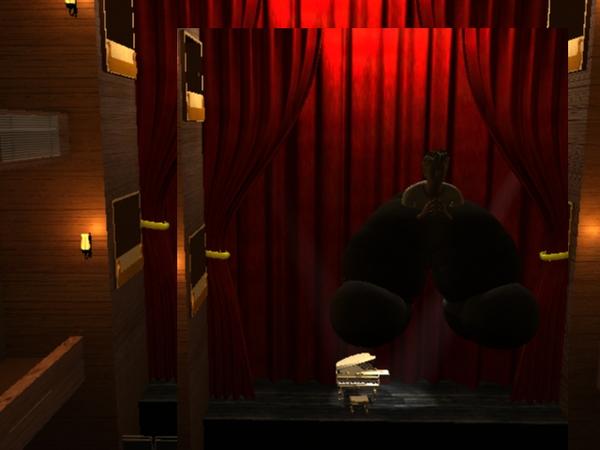

What i need to do is to fill a theater i made in maya with a lot of people, so i decided to create all this people with daz studio.
i have daz studio 4 and maya 2012.
1, i need to import a LOT of figures. i am kind of new to maya and defintely new to daz. so here is my problem i decided to test the exportimport with a simple genesis model, i did it a as a FBX , Ascii 2012. but it looks like the pants and boots didnt quite work well, here is a image of my render, he is suposed to be sitten. what i am missing? what do i need to do to export it correctly, or to correct it?

al right, but i need at least to export some models into maya and get them rendered right. so what do i need to do to see my character right? as you see the pants and boots look big and are not fit to the boddy. thanks

jochaxbu - 24 October 2012 09:35 AM
You can purchase the Decimator tool, which allows you to adjust the number of polys in the figure and clothing. It is not to hard to use and allows the user to control the level of detail. Then use the FBX Export tool to take the model to Maya.
Decimator
FBX Docs
This should help you get what you are after.

You need to check your fbx export settings, something’s wrong if the clothes don’t match the figure. In FBX export options, enable Merge Clothing into Figure Skeleton. Also, make sure the clothing is conformed to the figure and that props aren’t in the hierarchy.
