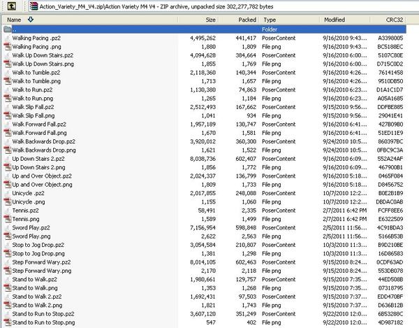

    Might be description confusion. The packs I've bought from Eclipse have all been PZ2 files.
    827 x 647 - 143K
    Post edited by Kevin Sanderson on
  • DartanbeckDartanbeck Posts: 14,638
    Sweet. Much nicer, for me. ;-)
