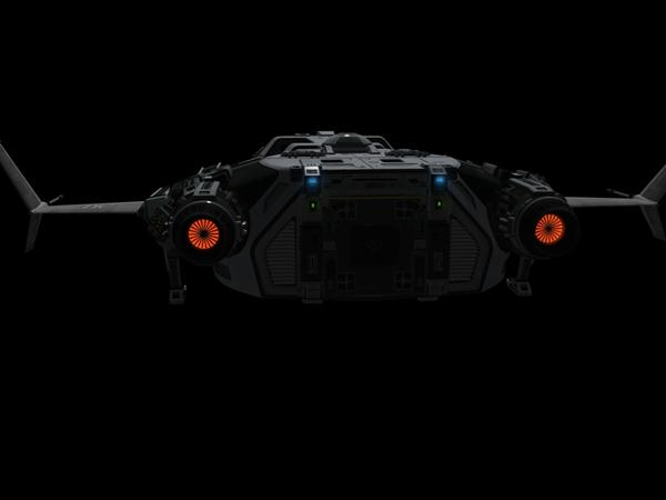

  • RiggswolfeRiggswolfe Posts: 787
    Well the object has been made to glow in the glow channel. But I thought anything glows putting out light would make it brighter and look more like a spaceship's engines as well as making the inner parts of the engine look lit up. I was sort of able to do it with a model of the spaceship from the black hole using a combination of anything glows, the glow channel and a 3d aura.

  • thoromyrthoromyr Posts: 444
    The effect you are probably looking for is "Aura" under the object's Effects tab in the assembly room. For a nice effect have it decay over distance.
    I tried it with 3d Aura and also with a multiply. I stuck with 100 because when I went higher the glow went totally white for some reason.
    It's better than Glow alone though not perfect. Ironically I think the little landing lights or whatever look better than the Engines.

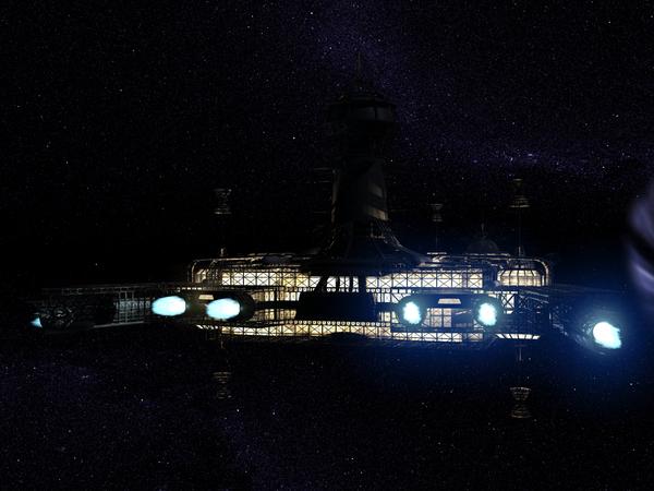

    To give an idea of what I mean, there is the image from one of the space ships sold in the store here. It may be postwork but I've seen a lot of Carrara renders around that look like this.

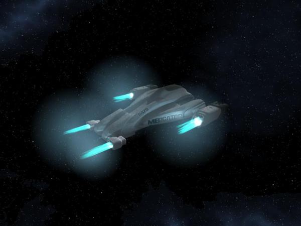

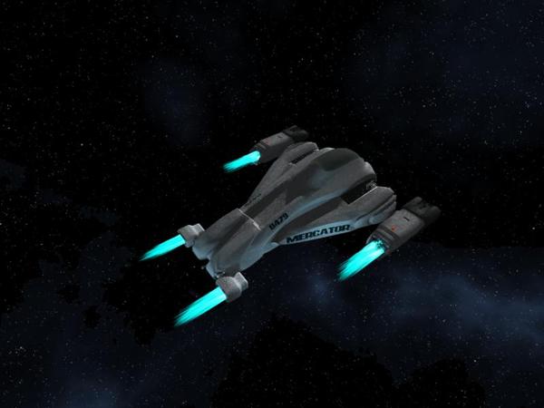

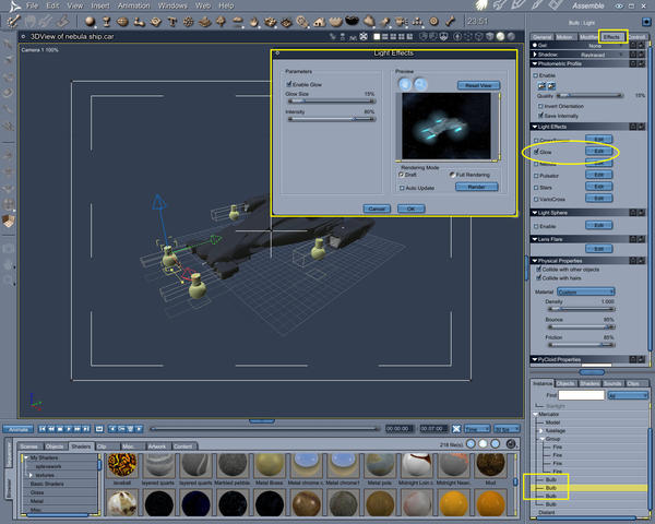

  • 3DAGE3DAGE Posts: 3,298
    HI :)
    If you first, add a Bulb light,. behind your engines,. it will be able to cast light on the Hull and the engine,..
    then you can go to Effects, and add a Glow effect to the Bulb. and set it as you want.
    You can then Duplicate that Bulb,. and place it behind the other engine,. It'll have the same settings and effects.
    In these images, I created a Starfield background, Using a Sphere scaled to 3miles, and a procedural shader for the nebula and stars.
    I used the Fire primitive (cylinder shape) for the jets. (the fire primitive can be animated)
    Images:
    Ship with bulb lights, plus Glow and Glare,.
    Scene Setup and effect settings.
    Ship with lights. no effects
    800 x 600 - 40K
    1280 x 1024 - 266K
    800 x 600 - 37K

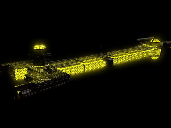

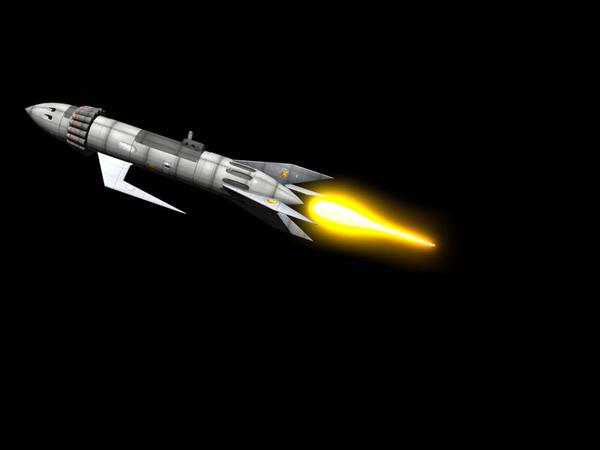

    Just as a general thing, 3dage's advice about using bulbs is a good one: while it may be tempting to use anything glows you are probably better off using bulbs and spotlights to mimic sources of light in a scene.
    To illustrate what can be done using objects and shaders the following is just a rocketship model (from Daz, forget which one) with a deformed sphere to use as the jet. One advantage over the fire primitive is that it is bulbous (the fire primitive is comprised of an array of parallel* strands, one consequence of which is that it can only be used for jets of flame) and can be twisted to suggest a turning motion.
    The shader is entirely procedural, uses the glow channel and 3d aura. One thing it demonstrates is the limitation of Carrara's post processing: there is no antialiasing. To remove artifacts from around the deformed sphere object I used photoshop's healing brush.

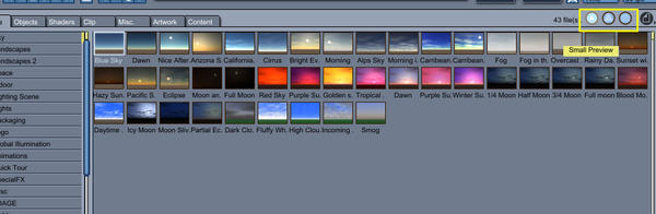

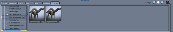

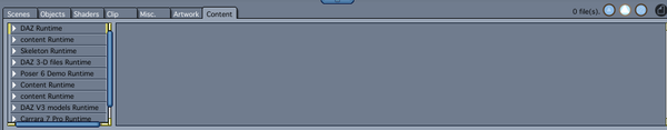

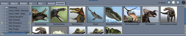

    Oh, a big, big question I have about the browser. Two really. 1) Is there anyway to organize it like how you can categorize things in Daz? And 2) Is there anyway to make the icons bigger? The thumbnails are TINY and I find myself squinting a lot trying to see them better.
  • araneldonaraneldon Posts: 704
    edited November 2012
    Yes, the thumbnails are tiny and can't be made larger than what the two options allow.
    Content organization outside of Smart Content is done by moving the files and folders, it can't be done within Carrara itself.
    Post edited by araneldon on
    for the shaders,. and tweaking them. this thread may be helpful,..
    http://www.daz3d.com/forums/discussion/11897/
    As Araneldon mentions there are two size options,. ...small,.. and smaller ... :) .....or text only >:-( ....three options :)
    Carrara is more that just a content loader and renderer, so it actually makes more sense to Not have that "Automatic" content searching thing going on, since, you don't actually need to have ANY content in Carrara,. you can start by building your own sets, figures and props and organise them as you need them.
    There's not many options for re organising content into categories, since the files that Carrara saves are "Carrara files, and can be just about anything from a shader, or particle system, to a full scene with multiple figures,. physics simulation and dynamic hair. etc..
    As far as Poser / Daz3d Content,...
    that needs to be organised using those applications,..
    Carrara only reads the runtime and displays what it finds.
    Smart content in the 8.5 beta, does help,. but not everything is smart yet,. and the process of doing that "may take some time" :)

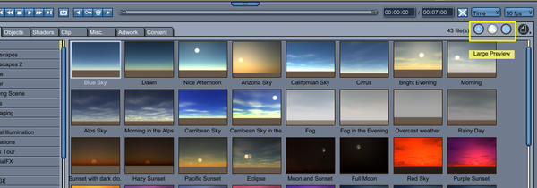

    Oh, that large preview button helps a ton! I'm no longer looking at something smaller than a postage stamp! Thank you for the scene and the answers. I'm going to check out that thread as well.

    Others have mentioned the nature of Anything Glows. I do like the bulb lights in conjunction with the 3D light sphere (under the light's effects tab). Using that along with either a volumetric fire or particle generator can give a nice effect. I will also sometimes use a lens flare along with the light sphere.
    I should also note that if you plan on making any interior shots of the Vanguard model, you will probably want to copy and paste the instrument panel displays into the glow channel as well as any light shader domains. It can be time consuming, but when you're done, you can drag and drop the multi-colored ball at the top of the shader hierarchy to your shader browser for later use. Simpler yet (especially if you've added lights to the engines and the interior of the craft, would be to make sure your lights are all grouped with the Vanguard model, and then drag the Vanguard to your Objects Browser to save the whole thing.
  • evilproducerevilproducer Posts: 8,920

    Bit confused by this. Are you having problems finding a figure or prop in Carrara that shows up in DAZ Studio? You can add runtimes manually if they don't show up in Carrara's content browser, by clicking the little black icon on the far right of the browser window. You should be able to click or drag any of the items under the content browser. To add a mat file, make sure the top level of the figure is selected and double click the mat file and it should apply to the figure. You'll still probably need to adjust the shaders in the shader editor because, as with all 3D programs, Carrara has it's own shader engine and some things don't quite translate correctly.
    No problem :)
    the space scene is just an idea I'm playing with, and the shader is very simplistic right now.
    you can adjust the stars, and nebula cloud by adjusting the "curve filter" for each of those elements.
    but,. it's just an easy solution,. (drop in a ship) animate, and render.
    Going back to your image with the ship from the Black Hole, I have that model and a more detailed one as well. (I'll try and find the link). I played with the glow channel and noise functions and got a pretty decent effect. What really helped though is getting rid of the glow channel and instead use translucency with internal lights. I'll post an example that uses transluscency and internal lights and where I used the fire primitive, bulb lights with a light sphere and a lens flare for the jets firing.

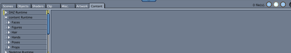

    Do you get the thumbnails of the stuff? Regarding the runtimes updating automatically, I don't know how D/S does it, but Carrara's update automatically.
    Carrara displays the runtime hierarchy under the Content tab of the Browser. You can have multiple runtimes as shown by my screen shot. Figures (including conforming clothes, hair, vehicles, etc. because it's "rigged" and is considered a figure) is where you find V4, M4 etc. etc. The Pose directory is where you'll find poses and .mat files. Props is usually where you'll find non-rigged and static objects for use as props.
    I know from earlier versions of D/S that you could categorize your figures and props and stuff, but that was all just an internal way to view your stuff, it still used the Poser style runtime file structure to reference the objects. Move anything out of the directory and D/S would be lost. The new system categorizes automatically by using Meta Data as I understand it. C8.5 is also supposed to use the new Content manager or whatever it's called.
    As long as you've added the Poser or DS Runtime folders,. Carrara will update those,. and the same applies to any other folders added to the browser,. carrara will auto refresh when any new items are added to those existing folders,..
    It's only when you install a "new" item into Carrara that you "may" * need to add the folder for it to the browser, and select what type of files are in the folder.
    * (if it's a scene, or other item built for carrara, it may be added to an existing folder and show up automatically)
