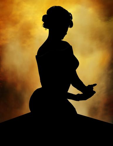

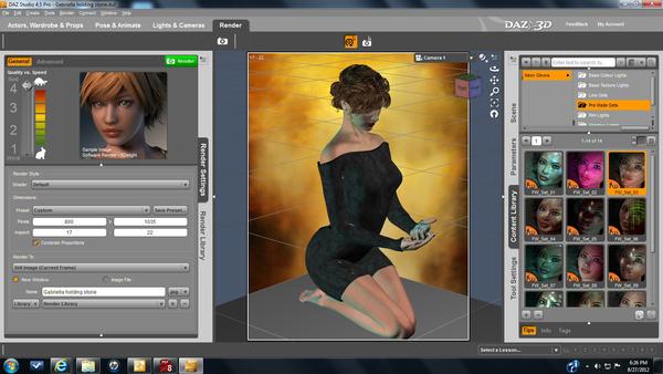

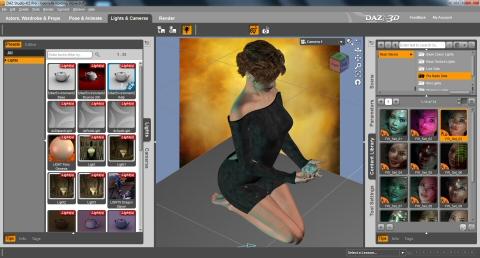

    Thank you Jaderall. The stone/parent thing worked great. Unfortunately, I still can't get the lights to work properly! I've tried adding a camera and checking to see that lights are pointing at subject (they were), inserting each element separately, but still doesn't work.
    As an example, the screen shots include one with set_03, which only shows the green glow, but nothing else, and set_07, which completely whites-out the floor plane and does nothing else. Each render results in a black shape.
    I really would like to get this to work. Anything else you can add would be much appreciated.

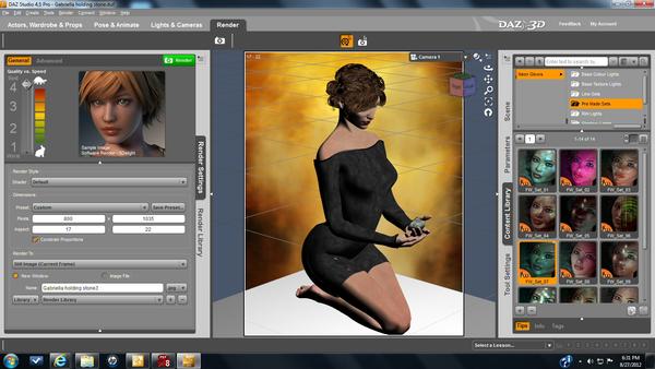

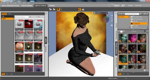

    Actually, set_03 worked okay...go figure (don't ask me how), but set_07 still resulted in a black outline.
    By the way, the readme is an html page, but all the links (including the product documentation link) results in this: We are sorry, but the page you are looking for cannot be found. Not very helpful.
    Here are the screenshots (larger) of both the render settings and the rendered .jpg for set_03 and set_07.

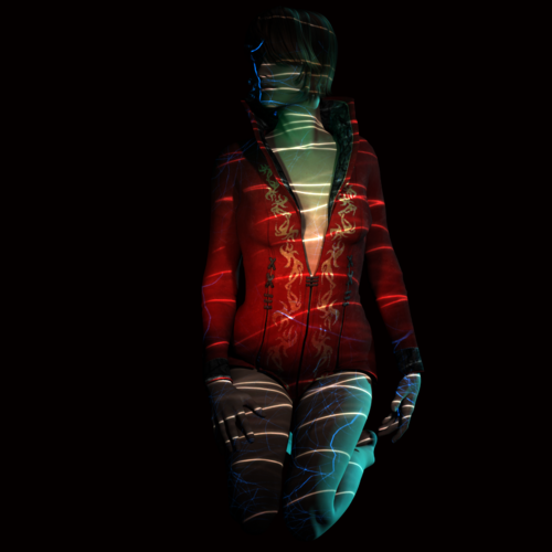

    Okay this is what I learned playing with this set.
    (1) The presets work 100% in DS3, not so much in DS4.
    (2) You will need to set the lights by hand in DS4.
    (3) The artifacts disappear when you set all lights to Raytraced Shadows in Parameters.
    Here is what I did in ten minuets by just playing with the lights. Tip: Many test renders.
