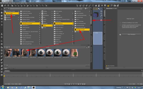

Hi all,
I am encountering a problem in removing short hair to Michael 4 (while keeping materials as skin color, body hair, eyes and so on). With Victoria 4 there is not problems but with Michael 4 I don't understand how I can do it.
Well if I do apply the Aged for M4 (I also own Aged for M4 and M4 Morphs ++) the hair is removed but also the textures(materials do change obviously. What I need is to keep the original textures/materials, and removing that short hair from head.
Thank you in advance.
To better explain what I mean here is a image sequence.

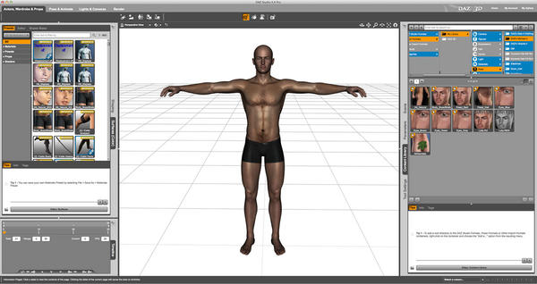

    if you don't have this http://www.daz3d.com/michael-4-skin-maps-std-res or this http://www.daz3d.com/michael-4-skin-maps-high-res like my screenshot shows then I am afraid you will not be able to do it without using a full skin set that has a bald head.
    The M4 preset that goes white is called Mapless meaning it has no texture maps. ;)
    1680 x 1050 - 707K
