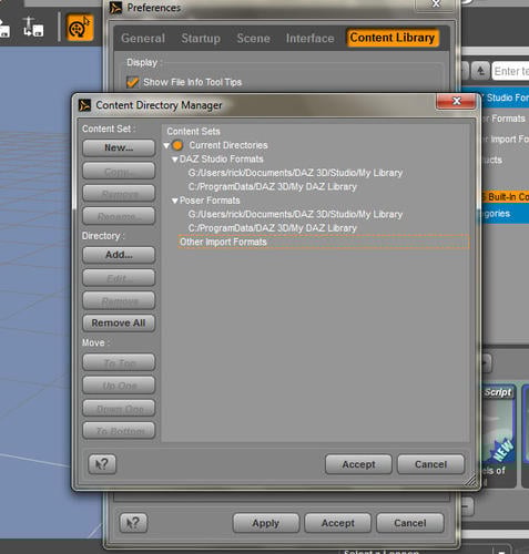

    I've attached a image of what you see in the Content Directory Manager now. I thought I had set everything when loaded correctly so that I could use the G drive. I'm not sure what paths to what I need to add here for the software to see all files correctly?
    And yes when I loaded 4.6 it did an auto uninstall of 4.5.
    First I installed the Install Manager 1.0.1.59 < Which I could only install to the C drive. Then the IM allowed me to change paths to what you see in the attached image and had me load the following files.

    If you used the DIM to install Genesis, and the other items, they would not be installed to a folder called My Library by default. Did you change the path inside DIM to go to your G drive, and the My Library path?
    I don't know why you also have a My DAZ Library in Program Data as it is a hidden folder by default, and I'm sure it is protected by Win7 or Vista in the same way that Program Files is. If you don't have any user content in that folder, then remove it from the list in the Content Directory Manager, from both DAZ and Poser formats.
    If you used the DIL to install to the My Library folder on the G drive, and the content is there, everything should be OK. If you look for your content in the Smart Content pane, and you don't see anything, we may have other problems, try the Content Library pane instead, and look in DAZ Studio Formats > My Library > People, and you should find all of the Genesis Essentials stuff there.

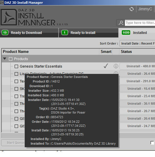

    You have a My DAZ Library inside My Library, that should never happen. If you installed Genesis Starter Essentials using the DIM, it should be able to tell you where it intalled it to. If you go to the Installed tab inside the DIM, and hover the mouse over the Genesis Starter Essentials name, you should get a pop-up box like I have displayed below, and it will tell you where it was installed to. Please post a screenshot like that.
    540 x 546 - 229K

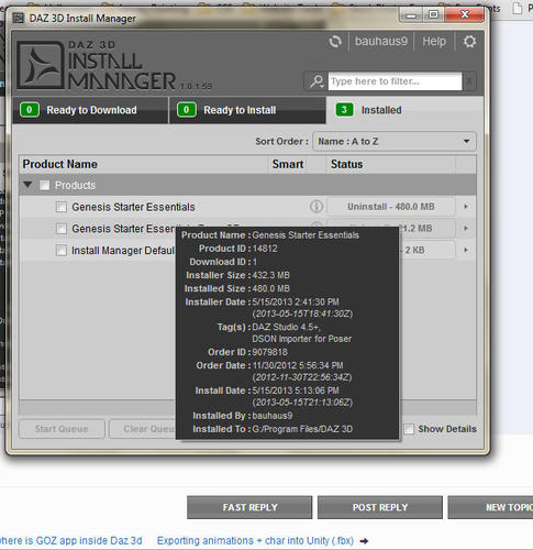

    Here you go.
    Looks to me like the files are in G:/Program Files/DAZ 3D
    And the software was installed in the DAZ 3D folder in another folder called DAZStudio4.
    On still confused on what I need to connect. :/
    638 x 658 - 92K
    You must have told the DIM to install it there, it only puts it where you tell it to :)
    What you need to do now is either move it all to the correct place, or much simpler, just leave it where it is, I don't think Program Files on the G drive will be protected by UAC (not sure).
    Add that path to your Content Direcory manager under both DAZ Studio AND Poser Formats. In other words, get rid of the other entries, and add G;/Program Files/DAZ 3D instead, as that is where your content is installed to.
