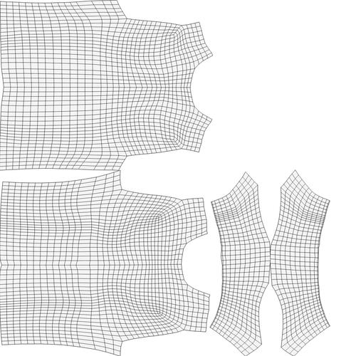

    Everything that takes textures should be UV mapped (a way of mapping the 3d coordinates to the 2D texture)...so the likelyhood of two different items sharing the same mapping is extremely low. But if the layout is similar and stretching won't be a problem...it could work. But that still won't shorten the sleeves.
    To to that one of the easiest ways is to make a transparency map and apply it to the 'opacity' channel (in surfaces)...basically make an image of the item (most have a texture map or template to start with). Black is transparent, white opaque...and you paint the areas you want to disappear, black...
    All of that needs to be done in an image editor...like Photoshop or GIMP.
    (template/maps are from my own t-shirt)
    First image...template
